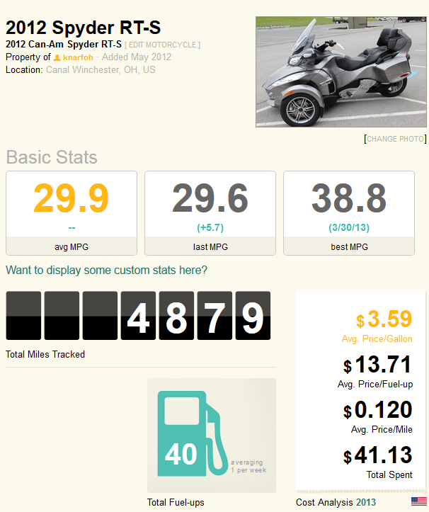

    Quote Originally Posted by meathead1978 View Post
    I just purchased rt limited I have only 200 miles on it i had to fill up twice now my gas light came on each time I went to fill it took only little over 3 gallons also after I filled up today the bike cut off I retarted it no problems driving home any thoughts?
    The gas gauge is notoriously unreliable on Spyders. I have a 2012 RT-S SM5.
    If I hold the refueling nozzle right and upward (almost under the upright seat), that seems to maximize the amount of fuel that will be pumped into the tank.
    If I let the nozzle rest downward, I might get around 3 gallons of fuel in the tank before the automatic shut-off.
    Anyway, I have tracked mileage since my purchase new.
    My BEST fill-up was just the other day. LOL. I forgot my own rule and only put in 2.6 gallons. The fuelly.com website assumes you are FILLING the tank each time so it calculated I got 38 m.p.g. LOL.
    Typically, I get around 30 m.p.g. My mix of driving is about 50/50 i.e. city/highway driving.
    My 2012 Chevrolet Cruze gets 34 to 36 m.p.g.
    The Spyder is not a high mileage motorcycle. My last motorcycle, 1500cc Goldwing typically got 40 m.p.g.
