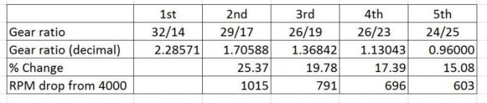

    Quote Originally Posted by NancysToy View Post
    It will drop more than that in some gears, so 4,500 is safer. Although we can nit-pic the stall point and shift points, for most owners it is safest just to round off the numbers to the nearest 500.
    First I was right about keeping it above 3400 rpm, but I was wrong about the rpm drop on an up shift. Shame on me for not doing the math. Thanks for catching that Scotty.
    One thing that was not mentioned about the RPM level is that, per the RTS Maintenance Manual, the charging system requires the RPM to be at or above 4k to prevent draining the battery. I believe this holds true regardless of model or transmission. So as long as your RPMs are at or above 4k - NO WORRIES!
