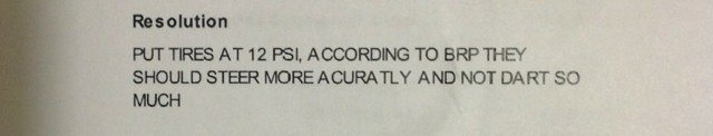

    Default Does any one know of a fix yet? ST-S Steering???
    When I went to the dealer for 600mile check I ask them to make sure the checked and left the tires at specs from manual. Which I went slight over at
    Front:17
    Rear: 29
    Below is the crop of my bill and the comments of the tire portion and just adds to my confusion on the subject. Mind you I am not having or notice any steering problems.
    WTH?
    It's been raining I have not ride it since I returned from the dealer but tomorrow I will check what the pressures are.

    Are the new tires' sidewalls marked with a minimum pressure like the earlier (14") tires were? If so, I would not go below that.

    Quote Originally Posted by NancysToy View Post
    Yes they are marked 15min to 30max. So I dont know what the deal is with the dealer and pressure of 12psi. I just DL the 2012 RS manual to compare and cold pressure there is 13Min and 17max. ST manual states 15psi +/- 2 psi. Basically the same.
    I understand we all have different take on it and what feels best Im just confused why the dealer is so way off. I wondered if dealer has RS specs in mind at first and not looking up new specs for the ST but its basically the same. Anyway I learned a lesson as stated by others check it myself as part of T-CLOS not gonna trust the dealer all out nor do I feel I need to educate them.
