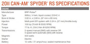

Engine specs

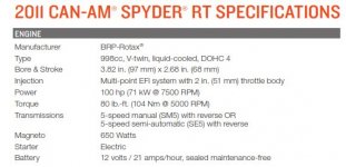

2010 engine specs

Originally Posted by Lamonster
I would like to see the curve of the RS, I doubt many RS owners run at 8500 rpm where peak horsepower is.
I think you're right about that. I am a little rev happy and shift at 9,000 rpm once and awhile, but I think that many never see 8,500 rpm. I seem to remember once seeing a torque and horsepower chart for the RS engine. I can't find it now.

different view
Peak HP is reduced but the torque is generally higher over a wider rpm range. That equals better drivability characteristics for touring.
2018 F3 LIMITED
Horsepower makes for Bragging rites,
Torque makes for pulling power, and thats at 6250 RPM.

The peak power in most vehicles is at an rpm that most people don't reach often. Take a look at your truck, car etc.
I would love if all vehicles came with a dyno chart on the window sticker instead of some peak HP and torque figures... Tells a more useful story.
If all the 2013's are 12.2:1 then they all require minimum 91. If they used direct injection then they might be able to use 89 without any noticeable loss of power, performance or mileage.
The torque curve on a RS is pretty flat... and starts fading around 8k. The RT torque climbs until about 60ftlbs at 5500 and then falls off. (remember this is at the ground whereas BRP's figures are at the shaft.)
