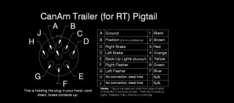

????? The center pin on the RT trailer connector is the ground. Something is amiss...possibly your testing procedures.
It is doubtfull the trailer is incorrectly wired. It is factory wired and I have yet to see a faulty harness...unless it was modified. One other thing to check real quickly. Many dealers have improperly installed the trailer module, and have left the cable exposed on the inside of the wheel well. It contacts the belt/sprocket and gets worn through. Check under the fender for possible damage.
Here is a pinout diagram for the trailer module. Not all of these pins will be functional on all versions. For the latest version, the brake and turn signal functions are combined on pins C & D.
Where the dealership Installed the plug, on the bottom side of my left saddlebag....the center pin is the hot one....thanks for the diagram, this is what I was looking for.....Well this is what looks to be the problem, now Soon as I can get off work, hopefully it is not raining...thanks Nudels

"Hot" to what...another terminal, or a chassis or battery ground. If it is hot to ground, you have a faulty or improperly installed module, or it is damaged and shorted out inside the wheel well. If it just check "hot" to another terminal, it is the other terminal that is hot, and you have the poles reversed on your tester.
-Scotty 2011 Spyder RTS-SM5 (mine) 2000 BMW R1100RTP, motorized tricycle & 23 vintage bikes 2011 RT-622 trailer, Aspen Sentry popup camper, custom motorcycle trailer to pull behind the Spyder
I put my alligator clip on the frame of the scooter, I stuck the pointed part of the tester, the only pin that was hot was the center pin.
I turned on emergency flashers---only the center pin hot---I tested all pins
left blinker---only center the pin hot---I tested all pins
right blinker--only center pin hot---I tested all pins
held brake lights on--only center pin hot---I tested all pins
running lights---only center pin hot---I tested all pins

Either your trailer module has been damaged, or the back-off module is screwing up the works. Many back-ff modules are incompatible with the Spyder RT. I can't say that the wiring the dealer did is first class, either...very amateurish, and jury-rigged appearing. At this point I would remove the back-off module from the system and test the trailer module again. If it still is hot at ground, it has either failed or has been hooked up in reverse...probably from bypassing the plug-n-play wiring. Your dealer is to blame, but whether or not he will make it right is anybody's guess. Sorry for the bad news.

About 20 hours of trouble shooting & got-er-done....The T-Plug was not pluged in very well and after resolving that issue the modulator started working properly getting the right pins to get hot when being used. Then the trailer was still not getting any heat. The plug was hot so I started tracing down the wires. The harness has that lead wire that goes inside of the tounge and then it has another plug which then goes into the trailer and plugs into the harness. I disconnected it and it was hot, put die-electric grease on it and plugged it back in good and everything works.
While I was in under all that plastic, I put die-electric grease on every plug that I could find.
