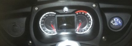

    I installed a marine grade voltmeter - Faria: http://www.boatersland.com/far-12821...FUcHRQodhEZfdw It ties in nicely with the stock gauges.
    I used the existing power supply that went to the temp gauge - orange is positive, black is negative. You may need to tap into both of the orange wires if your gauge has a separate connection for the gauge light - mine did. By tapping into the existing lines, your gauge will shutdown when the bike does without putting a drain on the battery.
