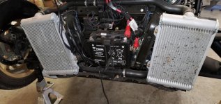

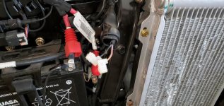

    Depends on where you want the lighting, there should be an aux 12v power lead behind your frunk and your BRP operators manual also mentions a fuse that can be moved in one of the fuse boxes on page 60 - 61 for the rear power outlet that will switch that outlet from always on to switched. I've had to remove my frunk to get access to a folded over switched 12v power lead, some folks can find theirs when they unzip the frunk liner (like they were going to access the battery or fuse boxes). My '18 had that "extra" power lead hole plugged but you could see the lead with the frunk pulled off.

    Last edited by Peter Aawen; 02-04-2024 at 11:23 PM. Reason: Fixed attach display ;-)
