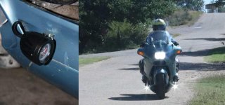

    My take away from this is you are looking for a place to mount lights that you already have with a single mounting bolt. I had a similar dilemma when looking for a good spot to mount some driving lights on a motorcycle several years ago. I wanted the down very low and separated as far as possible. I chose to put them just under the heads by drilling a hole in the fairing, then to add strength made use of a 3" x 3" backing plate on the inside of the fairing. I made that plate out of 14ga stainless steel with the same size hole as through the fairing right in the center. Over the course of 10 years and 62000 miles that set-up never gave me a problem. No movement of the lights and no cracks developed in the fairing. I did have to make my backing plate contoured to fit the curve of the fairing but that was a pretty easy task.
