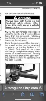

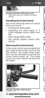

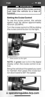

    There is activation of the CC and there is turning it on/off. I do the same thing, leave it on ready when I want to set it and either cancel it with the brake or turn it off. Then I immediately turn it on again so it's ready next time I need it. The Goldwing CC worked a little differently, but pretty much the same.
