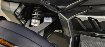

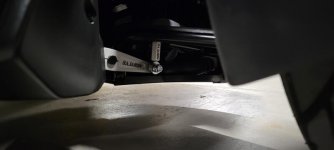

    I have the same Spyder and I'm the same weight. I installed the Ultra-bar with height adjusters for those time when I ride two-up or carry extra stuff in the storage compartments.
    I have been riding all summer and have found that it makes a huge difference with handling. I really like it. Best upgrade so far. Ron's team is awesome too!
