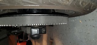

    Here's a pic of the rear sprocket.

    If you look closely at that pic you've provided, you can see that there's actually juuust a smidge of a gap between the belt edge & the pulley! So if the belt tension is in the right ball-park, & the vibration doesn't bother you too much, I wouldn't touch that belt JUST to change the belt being that close to the pulley... Well, not unless there's indications/witness marks that we can't see in the pic that are visible on the pulley showing that the belt is pressing too hard on that shoulder & the belt's trying to climb up it, &/or there's signs of excessive wear/possibly overheating on the edge of the belt that's hard up against the shoulder!
    When it comes to belt alignment, getting the tension in the right ball-park is far more critical than getting the alignment EXACTLY correct; and really, you only need to make sure that while moving in any direction, the belt isn't climbing or wearing excessively on the shoulder on the inside edge, &/or that it's not walking off the outside edge. Anything else is pretty much OK, and if you wanted to bother with mounting a camera over that belt to watch what it does while you ride, I reckon that you'd be quite surprised at HOW MUCH the belt moves on the pulley anyway!
    So unless there's some other reason for adjusting it & there's no signs that the belt is being compromised by being that close, I'd recommend you simply leave well enough alone! A few years back, I ran for basically the whole year & about 30,000 miles with my 2013 RT's belt looking very much like yours does in that pic, and that belt is still going strong with NO signs of adverse wear, despite it now being many miles and quite a few years later!

    with Peter. If tension isn't tight and the dampener works for you then leave it alone. Your alignment is great on that rear pulley.

    I agree with Peter & Navydad, the belt looks perfect as is. Another thing, anytime you look at the belt make sure that you have traveled in a straight line for a bit. If you have just turned into your garage or parking space it will not be correct.
