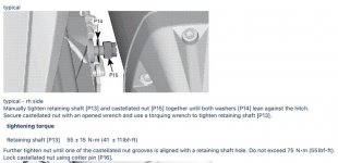

    Default What's the axle thru bolt nut torque? 2015 RT trailer hitch
    Just put new tires on Spyder, had to remove hitch, reinstalling hitch but can't find torque spec for this bolt. Maybe good and snug with castle nut aligned with hole in axle and new cotter pin?

    If you're talking about the hitch bolt and not the axle nut then yes, just snug it up good and pin it. Don't overtighten it and don't leave it loose either.
    If you just want to torque it then 15-20 ft lbs will work.

    Here are the torque specs for both the RT and F3 Had to do the same thing last month.

    Quote Originally Posted by Wmoater View Post
    A good bit more than I had thought, thanks Wmoater
