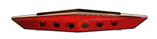

    The light on my Ltd top-box has failed and I am looking to replace it.
    I have checked and there is power going to the plug, so its the light.
    t l 4 20230308_105920.jpg t l 5 20230308_110302.jpg t l 3 20230308_105905.jpg
    e-bay points to this.
    SPI Rear Tail Light Assembly w/ 6 LED Lights for Ski-Doo Replaces OEM# 520001143 which is the correct part number.
    It looks right ( apart from the lens is darker on mine ) but im wondering if they have the brake light incorporated into that . Ski-do with brake lights?? When I do will it fit it says no. Thinking that may be the brake light bit.??

    This is confusing because that is the correct part number for that light; but for a North America version of the bike. Reference parts catalog item #400, of drawing 10- Electrical System - Upper - T, LTD. I believe the easiest way to decide you are getting the right light assembly is to verify 3 wire configuration. If the light has only 2 wires; that's running light and ground. Three wire is running, brake, and ground. For a US customer, that part is US$96.99.

    Juuuust on the off-chance, are you SURE that light ever worked??
    I have a vague suspicion that only the North American Spyders got that Top-box light, cos IIRC, there's been a few complaints from Oz/NZ/EU owners that they didn't get the factory light up there?!?

    I need the 2 light set up. Tail and stop.
    Have you got a link to that parts catalog?

    I can't be sure it ever worked when I got it 3rd hand. It has a plug attached from the loom and have checked with my test light and there is power to at least 1 of the terminals. Couldn't step on the brake at the same time. Presume 1 is the earth / tail and stop. Just ripped out and here is a photo.

    Well it was doing my head in once I discovered that light was a useless bit of bling and not a high stop light.
    So I have ordered one from the UK from that MartinTheVoyager bloke.
    Nearest dealer wanted $350 nz and offered to order for for me.
    Cost was 110 quid / $200 nz / $186 au delivered. Which is still nuts but what do you do?

    So just to finish off should another Bloke go down this road.
    Ordered from MartinTheVloger the end. Arrived in 9 days. Slovakia to New Zealand. Not bad.

    in US you guys can buy it.. in Europe we cannot... in US it is standard on some models, in europe NZ and Australia it is not allowed
    but we have solution
