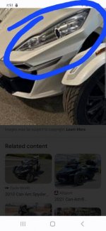

    I have a 2017 RT and I'd like to add the light assemblies that go next to the frunk lid.Screenshot_20230108_145155_Chrome.jpg
    Anyone know if they will fit if I take out the black plastic pieces that are currently in there?

    Does someone make them yes both OEM and aftermarket .... But none that I've seen are bright enough to mean anything .... I just bought Denali " D-2's " and they actually exceed what a high power LED headlamp can provide ..... these suckers light up the night .... good luck .... Mike .....PS I recently bought them on sale for $ 98.00 shipped with a complete wiring harness including a separate fuse and on/off switch that's illuminated..- google Denali and see what they have ....I believe the OEM re-placments are about $270.00 each

    If you were in the same country as me (Australia) I'd swap you. Here, they are our headlights and are very poor. The OEM ones seem to be mostly related to the lense/reflector design.

    Do you want them for real foglights, or for decoration? In either case they will be very pricey. As foglights they're not that good unless you swap the bulbs for LEDs. As decoration they do enhance the appearance of the front of the Spyder. If you want truly good functioning foglights do as Mike suggests and look a add-on LED lights.
    As for which year of light to get if you do go that way the BRP lights should fit all years of RT from 2010 to 2019.

    The PNs are 710003256 (L) and 710003257 (R) @ $329.99 ea., and I am not certain what other parts one must purchase to complete installation. I switched my bulbs to LEDs several years ago; much brighter than the Halogens.
    The switch to go into the console switch group.

    Don't necessarily want them for more light- more for looks than anything else. Those plain black plastic pieces just look put of place.

    In that case I suggest you search for used ones on eBay or motorcycle salvage yards to accomplish that goal for less money.
