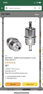

    I completed all of these things yesterday and even though it took me most of the afternoon I know it was done right and I saved a few (probably quite a few) bucks. The hardest part of it was getting to the fuel filter. It is in a different place to access..! But I’m just stubborn enough to stay at it til it was done. I got the oil change kit and trans filter from BajaRon and fuel filter from Amazon.

    Congratulations! And you probably did a better job that anyone else would. (We also sell the BRP fuel filters, by the way.) But what I want to caution in this regard is that we had a customer come in last month with a plastic fuel filter installed. He'd done the work himself and put less than 100 miles on the bike. The fuel filter looked like a pumpkin! It had swelled up quite a bit and frankly. I was surprised it had not burst. It was about ready to.
    The Spyder fuel system is under high pressure. You can't just use any fuel filter that fits. Be sure you have a fuel filter that can take this pressure. Otherwise, you're doing yourself no favors. The BRP filter is unnecessarily expensive. I'll give you that. And there may be less expensive options that will work just fine. But please, do not cut corners on this one.

    I used a metal type made by Wix so I’ll keep an eye on it. Thanks for the information..!

    The Wix should be good to go. You don't have to use a BRP filter.

    What is the Wix P/n for the fuel filter you used?
