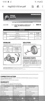

    Certain 2022 Spyders, both RT's and F3's came with a rear axle bolt that had an internal diameter too small for the BRP trailer hitch bolt to pass through. There is a BRP service bulletin addressing this, and it is treated as a warranty item. Since most people buying Spyders will never need a hitch, BRP is not treating it as a recall. If you have a Spyder affected by this, and you may ever want a hitch, you should put in a claim for the replacement rear axle bolt. They are available now. I've already added a hitch to a friends' bike that had the too small axle. BTW, dealers will not hand over the replacement axle bolt. They have to account to BRP for having changed it out.

    Contact your dealer and give him the attached bulletin. It is covered under warranty. Without doing the warranty claim there are no hitches that will fit the 2022's
    Campermac, could you PM me that bulletin. I can't print it off the photo clearly. Thanks.

    It took a bit of digging, but for those interested in printing the Technical Service Bulletin for this, the link at NHTSA is here:
    https://static.nhtsa.gov/odi/tsbs/20...14931-0001.pdf

    Thank you to AZ4U2C for posting the info on this. My dealer did not know about this and has now got the correct axle shaft and nut for my 2022 RTL.
