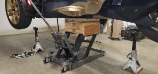

Though I do have and use common automotive Ramps for some Spyder maintenance, I also would recommend
something like the $140 (at this time) Harbor Freight PITTSBURGH AUTOMOTIVE 1500 lb. Steel ATV/Motorcycle Lift
or one of the many, many other heavily discussed Spyder lifts.
I've used the HFPA 1500lb lift on my Spyders for 7 years, done oil changes, cat deletes, airbag repairs/replacements,
Sway-bar replacements, and just lifted the bike to the top of it's lift just to really clean my wheels while sitting on a low mechanics roller seat. 20220606_205441med.jpg
Here's how I got it high enough to drop the stock sway bar. Of course I use jack stands for safety as well. I've even lifted the bike and slid the
ramps under the tires when I wanted to be on the Spyder with the engine running whilst checking for exhaust leaks even. Having both does help.
Safe Rides,
David and Sharon Goebel
Both Retired USAF Veterans
