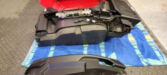

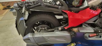

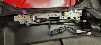

    You have to remove the saddlebag from the bike. After that is very easy and obvious to replace the latch. Remove the top cover and you'll see the screws that hold the saddlebag to the frame. It is basically hanging on rails and after removing the screws and the plastic pushpin at the bottom it will slide outward and off. There's a disconnect for the taillight.
