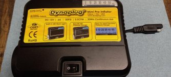

    Dynaplug Micro Inflator hooks to a battery tender lead,
    Not quite so. It does have an SAE connector as one of the cord options, BUT that connects directly to the battery, not to an existing battery tender cord. It cannot plug directly into your battery maintainer connection because the polarity will be reversed.
    What's in the box:
    - Dynaplug Micro Pro Inflator
    - Universal cig/BMW style power cord
    - Ballistic nylon dual compartment pouch
    - Battery clips to SAE plug
    - Ring terminal to SAE plug
    - SAE to SAE extension cord
    What's in the box:
    Pete, I think you overlooked the most important part for our use "- SAE to SAE extension cord". The unit itself has a SAE plug molded in so the various power options can hook up. You simply plug in the extension cord directly to the unit and the other end goes to the battery tender lead. The extension is more than long enuff to get to any tire on the bike.
