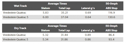

    Yes, as mentioned, the Continental will fit just fine. However, there are better options. I've got several very happy customers on Veredestein Quatrac tires. There is a 165/60/15 and a 175/55/15 available for the front of the 15" Spyders. I like both but the 175/55 really fills out the wheel well for a better look.
    Watch this video if you need some convincing.
    https://www.tirerack.com/tires/tires...es#testResults
    The 165 is the same width and slightly taller. The 175 is wider than the 165 but not quite as tall (though a bit taller than the OEM tire).
    The Quatrac-5 was a very good tire. But check out the improvement on the new version. I really take notice of the Wet Traction. As this is where you really need help with the Spyder. Especially on car tires.
    The Michelin Cross Climate+ (Blue Line) is an excellent tire. Unfortunately, it is not in a size we can use on the Spyder. Interestingly it has the same type of tire tread as the Vredestien Quatrac (Green Line). As you can see, the Vredestien definitely holds it's own against a very good tire in the categories that matter most to Spyder Ryders.
    As I said, they both work very well. But don't give Tire Rack any information about what you're putting the tires on or they won't sell them to you.
    EDIT Note: Just got off the phone with Tire Rack. I really like these guys. They try not to bash a product. But other than that, they seem pretty straight up to me. I wanted to ask about the Continental and Veredestien tires I have discussed here because I can't find a head-to-head comparison that I feel good about. They told me that definitely, especially for wet, the Veredestien is the way to go in the tire sizes I gave them. I wish they made a 225/50/15. Or at least a 215. But you have to go to a 205 to get a tire that will fit the rear of a Spyder.
    Which really isn't as bad as it sounds. The 205 still gives you a good amount of rubber on the ground. And the taller tire brings the speedo more in line with reality. But cosmetically, I really like the wide 225.
    The Michelin Cross Climate+ (Blue Line) is an excellent tire. Unfortunately, it is not in a size we can use on the Spyder. Interestingly it has the same type of tire tread as the Vredestien Quatrac (Green Line). As you can see, the Vredestien definetly holds it's own agains at very good tire in the categories that matter most to Spyder Ryders.
