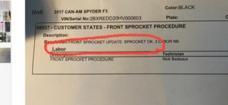

    I have a 2017 F-3T with just over 27,000 mile's. It has a Dynojet PV3 tune and a Pedal Commander, I hit it hard just about all the time. So it passed inspection today at the dealer
    pic taken 12/13/2020 Notice the shiny black painted surface, they all don't have that

    Quote Originally Posted by T.P. View Post
    T.P.
    That's a TECH that hasn't touched it yet .......... PS I hope you don't get spanked ( by the Dealer ) for having the POWER add-on's .....good luck .... Mike

    HEY MIKE, No spanking from the dealer on the power add on's
    I would say that in my case that "THE RED DUST OF DEATH" is a myth.
    Dealer said that of the 30 Spyder's tested so far only 2 failed.
    T.P.
    I agree with Mike. I'm not sure how that thing passed. Even if they didn't clean the sprocket off there would be hand prints from them checking the pulley for slop after removing the bolt (even though it looks untouched as well). But clearly no one has ever touched that pulley in some time. Other maybe than to have swiped at it where that dust is gone in what you call black shiny painted surface. Of course I could be seeing it all wrong.

    To the OP, was that picture after the preliminary recall was done?
    Clearly no fingerprints on the sprocket and no witness marks on the bolt. It doesn’t look like it was touched.

    OP says pic was taken 12/13/2020.

    YEP! That is a pic from 12-13-2020 and I have not looked at it since.

    Took a look at it today and it has been cleaned up a bit, but no markings on the bolt.
