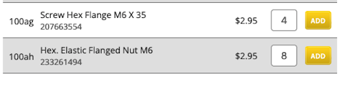

Just picked up a Used rally 2022 (60 miles on it), and had one of the mounting bolt and nut come off the sway bar end link ends. Was wondering if anyone knows the hardware bolt size for that, thinking of picking them up at fastenal, looks like a grade 8 bolt type.

Hi, you need a metric 6x26 with a 22mm or 7/8 shoulder and a appropriate nylon insert nut. I had to use some emery cloth to reduce that 6 a little bit but it worked OK.
