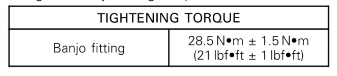

    Does anyone know how much torque to tighten the front brake caliper?
    Sep 2021
    Tri-Cities of Virginia
    17
    Quote Originally Posted by Sungate View Post
