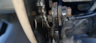

    Also not sure about the condition on the rear sensor here, broken ?
    I have changed the rear sensor once before and it's a heck of a job I know.
    Why did they put the connector in the "no reach" zone? Half the bike have to be dismounted
    So, I reckon there is no other option than taking it to a dealer and see if they can hook it up and figure it out ! And btw, brand new battery innstalled last week, so no power issues.

    I would pull that sensor and do a clean up job on it. Looks like a lot of dirt and maybe corrosion there. It doesn't take much to interfere with the signal that the sensor needs to read. I would also clean the ABS "ring" on the wheel. These ABS systems really aren't that complicated, but those components do need to be reasonably clean and free of crud in order to function. Crud blocking the signal will throw a code because the computer isn't seeing the rear properly. I hope your issue is as simple as a good cleaning. Sometimes that's all it takes. My Moto Guzzi is very sensitive about a dirty sensor.

    Pulled the sensor and cleaned the abs ring aswell. Took it for a little ride to see if codes cleared, but no luck !
    Now I will check battery connections and load test it like Bfromla mention in post below. If no luck there, off to the dealer I go.

    How much of a air gap do you have between the sensor and plate, it don't look like much from the picture! If the end of that has hit the plate and gouged it, you know the answer to that!! Sorry!!

    Checked the clearance today and it is almost 2 millimeters, so that should be ok I think. But somehow it looks like something has hit the sensor, maybe some gravel on one of my rides ?
    Leaving it to the dealer to figure it out now.

    New sensor ordered yesterday, so tomorrow I will start pulling of panels and have that part ready for when the sensor arrives.
    When new sensor is innstalled, should all fault codes go away by themselves ? Or do I have to go have it hooked up to a pc for reset ?

    All is dismounted and just waiting for new sensor to show up ! Hope it will be here soon, but not plasing any bets on it.

    New sensor arrived today and are innstalled.
    All parts back on the bike and I had a short test ride. All fault codes are gone and bike acting normal again
