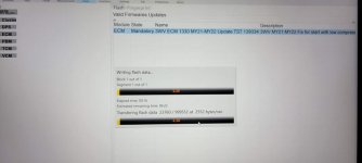

    I have a 21 Spyder RTL and there is a Service Bulletin out to do a mandatory flash of the ECM that fixes a low compression starting issues. I had to download the latest version Buds 2 from Powersports-diag. It still says it is the 21.1.0 which was the version I had originally but it did not show the ECM flash but installing the latest version (Added 4-15-22) fixed that and was able to flash the ECM. Not sure if this affects other years but it may be for all 1330 engines.

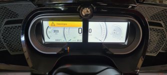

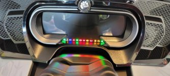

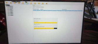

    This update did nothing at all for my 2020 RTL, however it did contain the cluster update and the ECM update for our 2021 F3L. It also has done away with the bug that was introduced in the previous version that caused my cursor to jump to the close program button at the top of the screen after about 2 seconds. Interestingly, it kept the engine running for the cluster update, but killed it for the ECU update. In the photos below you can see that the cluster update blanked the screen but turned on all the indication lights and was flashing the green arrows rapidly. The ECU update just showed the engine fault.
