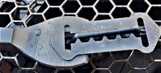

    All done. I used a tool that came with a boxed selection of push pins to remove the clips. There were 5 tabs vacant and where additional clips could be fitted, which hold the grill to the grill. There were 2 types of clips. So here are some photos which may be of use to someone if they want to have a crack at this.
    20220322_085908.jpg 20220322_085414.jpg20220322_085218.jpg20220322_110616.jpg20220322_113031.jpg
    So I post this. Hope it assists someone someday.

    I was thinking I would make it part on my Annual service. Like remove that grill and clean , also hose out the radiators.
    I noticed mine had 5 posts seemingly waiting for a clip.
    What are those clips called?

    So just messing about and I see I neglected the info on the clips.
    Here is the info I found:
    Garnish Interior Trim Bezel & Scuff Plate Clips For GM seems to fit.
    I did a post here if ya interested.
