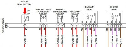

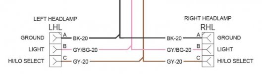

    Jetfixer -- nifty color pictures. Did those come from the 2020 service manual? Nice upgrade. My 2014 is grayscale.
    Dr -- same Gray color wire as 2014 but a different connector. And with 20AWG wire I assume the 2020 headlight is LED.

    yes, from 2020 service manual...
