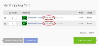

    Thanks Mike.
    In my search around Oznium, I ran across sets that they say are flexible in every direction. and a large variety of lengths. This is something they may have added since you did yours. The side reflectors measure ~10.5" and the rear ones ~5.5". Oznium flexibles come in 9.5 and 4.7 lengths now. So, the only thing left for me is knowing if there is room to put those small strips behind the reflectors. I'm guessing since you removed yours, you will know exactly how much space is behind them.

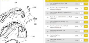

    Dunno, when he said he removed "all four reflectors" the only thing I could envision was the sides of the fenders and maybe the back ones or the sides of the saddlebags. I'm in no big hurry as this is a winter project so I can wait for clarification. Even better would be a picture or two (hint-hint Mike?)
    Is there a parts fiche somewhere that might show an exploded view of how the reflectors are fitted to the fenders?
    Took some digging, but I found this one showing "Pressure nuts" holding the reflectors on. Gonna take a closer look in the morning to see if I can decipher how to remove them without breaking.

    More common terms for p/n 250100163 are Push Nut, Speed Clip and Starlock Washer.
