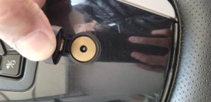

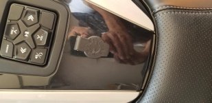

    On my 2020 RT Limited I brought power up near my handlebars. Later, as you can see, it's on a jack right in front. I use this power port for my tender and for my heated gear.

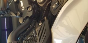

    Here are pictures of mine mounted by the right front wheel. I posted earlier in this thread how I did it.
