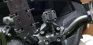

    BRP make a mount for the center of the handlebars. This set up is for my Garmin XT.

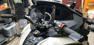

    I will post pictures tomorrow. What I did was use a flat base ball mount and short ram arm and using 3M automotive dubbed back tape on the flat stick it to the center of the dash (on the top of the dash). I ran the power wires around the right side of the dash through the windshield arm opening to the power feed on the right side. This feed is powered with key on so you don't need the Spyder running.
    I did this to both my 2020 RTL and my wife's 2021 Sea to Sky.
    What's great is you never need to take your eyes off the road to see it.
    Our 2014 RTL came with a GPS that was mounted in the middle of the handlebars and I always had to take my eyes off the road to look down at it. Especially with a full face helmet.

    I used the bar clamp from Lamonster. Didn't use the ball part though. The powered mount from Garmin fits perfect on the bar clamp without the ball and is at the perfect angle for me. Simply route the power wire to the connection point inside the right cover. There are lots of videos showing this process. If you get the lights added to the floorboard the connector for power will already be used. I simply tied into this point also.

    Here are the pictures.
    Not sure why these came out sideways and upside down. Tried to fix, but didn't work.

    PW2013STL where did you get the ball mount?..the base looks larger than those I have seen. Also any vibration issues? Thanks all.

    RAM-B-202 part number. Do an online search for best price. No vibration in the 27,000 miles it's been on.
