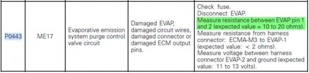

    From the service manual...
    More than likely your valve is stuck or the coil windings have opened up. Disconnect the wire going to it and remove it. Check with a multi meter using the resistance mode and see if you get close to 10 -20 ohms. If you do the coil is OK. I would then clean it out with a couple of shots of carb cleaner from both ends (non Chlorinated) and then get a few pieces of wire and a 12v battery and try to manually activate the valve. see if it clicks open. If it does not on the first attempt, reverse the wires (polarity) and try again.
    If the valve opens up then you have a good valve. If not, replace it. It is unlikely another issue with the wiring (but check) and if you do check the resistance of the wire harness be carful... same if your checking its voltage. Wrong setting on your meter can damage a ECM.
    Good luck.

    ... and yes... a computer ( ECM ) can tell if a solenoid (the valve) is working even on a 2 wire system by measuring the back lash (return spike) from the coil when the power is dis-engaged. It can tell when the coil is open, or gunked up depending on the waveform it sees returned.
