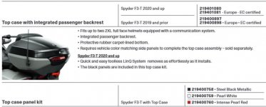

    The F3L has a LINQ topcase. Technically the F3T can have this setup as well but BRP discontinued the accessory kit to do so because of supply chain issues - they wanted all the parts to go to building new F3L's
    It used to be part 219401080 to add the LINQ adapter and top case to the F3T
    I tried working with my dealership to get the adapter plate and associated parts but everything was backordered and the cost was getting pretty extreme - so I ended up installing a SHAD top case on my F3T
