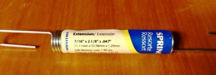

    It sounds like there's something more wrong down the pedal end, not sure what &/or how, but with all the other stuff added, if moving your foot away & occasionally lifting the pedal seems to help, maybe it's worth trying installing an extra spring on the pedal to help hold it up/make it return properly?!? . There have been others who've ended up doing this, most very successfully resolving their on-going issues, even if not actually working out what the problem really is - but hey, if it stops the Codes & Limp Home Mode, surely it's gotta be worth a shot?!?
    The pic below is of one spring that many have used - can't tell you exactly how to fit it on your Spyder, but it needs to help pull the pedal back up in order to make sure the micro-switch is not still being activated/touching when you're off the pedal....
    Good Luck!
