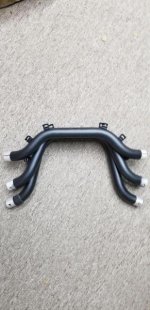

    This is a picture of the three bars, stock RT, stock F3 and short reach7CFE8296-FC09-413E-A854-A5E2D3E0E9EF.jpg

    I was debating F3 bars versus a 2" riser. I did the riser and like the results. After seeing this comparison picture, I'm liking it even more.

    Quote Originally Posted by Spiderfrog View Post
    So, it looks like the stock 2020+ RT bars are basically the same as the F3 accessory long reach bars.
    There is a big difference in reach between the two. Looks can be deceiving.
    Absolutely not. In that picture, the shortest bar (top) is the 2020 RTL OEM bar. The middle bar is the F3 OEM bar. And the third bar (bottom) is the F3 Short Reach bar. The gap you see between the top bar and the middle bar will be the F3 Long reach bar. That picture was taken by me after I ended up with the F3 Long Reach bars on my 2020 RT Limited.

    Quote Originally Posted by Copperman View Post
    Reviving an old thread here. Your picture doesn't show a F3 LONG reach bar. It shows OEM 2020+ RT/stock F3/short reach F3 bars. You say you ended up using F3 Long reach bars. What bar is closest to the rider, 2020+ RT bar or F3 Long reach bar? Thx
    You missed post #17????????????????????
    No !!!!!!!!!! I saw this.. "That picture was taken by me after I ended up with the F3 Long Reach bars on my 2020 RT Limited." So, I'd take it that the F3 Long reach bars are closer to the rider than the OEM 2020+ RT bars? Their are no photos of Long reach F3 bars, let alone a comparison versus 2020+ RT bars. Bottom line, for me, is if the 2020+ OEM RT bars are a further/longer reach than the F3 long reach bars, I might be interested in buying one.
    You ask above
    I thought that answered your question which is why I thought maybe you missed reading it. The only info not there is just how much closer to the rider the F3 long reach is than the stock RT would be.
