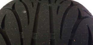

    Some people don't worry about either tread blocks! or wear bars!
    That's the most even wear I've ever seen on a rear tyre - do you know what pressures it was running?
    Here is a rear Kanine at 15,000 miles on a 2019 F3L, inflated to 23 psi cold (obviously too high).
    What are good/acceptable pressures for the rear?
    We both ride pretty hard and fast - 10-over where acceptable and pretty quick through the corners (even my wife, this is her F3L rear tyre). I've now dropped the rear to 20 psi cold, but on my 2015 F3S with factory Kendas that seems to provide a slight rollover effect under hard cornering acceleration through roundabouts and the like, which wasn't noticeable at slightly higher pressures.
    My wife seems to take left hand corners faster than right, judging from the front and rear tyre wear...

    Just trying to upload an image or two

    Thanks T, well it doesn't look like that tire is wearing evenly ..What is the measurement in the middle not at the wear bar ????? .... Mike

    It is not wearing evenly, but that would probably be a result of running 23 psi, possibly a little more earlier on.
    The centre tread depth is 2.5 mm near the wear bar, as shown in the photo. That 2.5 mm reading is the tread depth in the groove, not the depth of the wear bar.

    OK thanks - yes it is wearing MORE in the center .... At 23 psi I think it's too LOW not too High .... From research I learned the Kanine's are made to similar Kenda spyder tires .... meaning the casing's are weak ..... this causes pre-mature wear in the center section of the tire ..... un-fortunately there is no " magic " PSI to fix the Kenda / Kanine center wear issue .... any thing above about 25-30 MPH is going to cause the tire to BALOON .... this is what causes the Center wear ..... Mike
