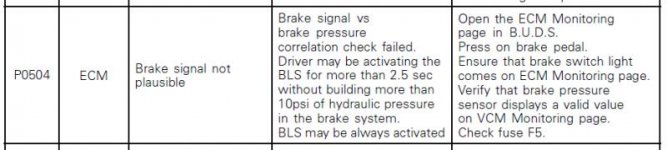

    Quote Originally Posted by cueman View Post
    Why do many think that the brake being applied while still on the throttle causes a fault code? Does your car do that? Do you know of any motorcycle that does that? Do you not see the videos of people on rykers holding down the brake and doing burnouts? If there is actual proof, show it.
    Simply because it does. Does not happen in 100 feet. Easy to prove to yourself. Lightly press and hold the brake and go for a ride.
    So you have no proof either. Just like the sky is falling!
    Maybe look at post # 26 or better yet Read The Fine Manual. That's not the only code it can throw.
    Yes, it happens. Try it for yourself. It's easy to recreate.

    Well, #26 is not plausible in this situation. If it was, there would be a very high percentage of incidents instead of just an annoying amount of “new rider nonsense”. As for me trying it, I’ve been doing it for nearly 3 years, and I’ll give you an example. Anytime a car is within, what I think is a reasonable distance to be notified of my intending stopping, I’ll “ride” the brake then “pump” it 3 times while on the throttle to notify the person behind me of my intension to stop. I do this as a safety for me and courteous to driver behind me do to the rapid deceleration of my Ryker when you just get off the gas. And YES, I’m a skilled rider of over 58 years and have competed in motorcycle competition in the late 60’s on and off to 2002. I guess you have your opinion and I have mine. No hard feelings.
    I agree that that code would not be the one thrown in this case, its just an example. But you are not riding the brake for enuff distance for it to throw one of the others. I agree with the no hard feelings. I just don't want someone to read over this and get the feeling that you can ride the brake pedal, like you can in just about any other vehicle (see we agree again), and not have the nanny speak up.
    The "situation" was driver riding the brake pedal. Applying the brake for more than 2.5 seconds without pressing sufficiently hard to generate fluid pressure causes a fault code.
    In the situation that you describe above, are you also applying the throttle? I'm pretty sure you are not.
    In the VSS code fault, the person is typically driving normally (throttle on) while also slightly depressing the brake pedal to the point where the switch is activated but not much pressure is being applied.

    The mechanic at the shop ran my bike through the computer and he looked at the VSS information and it went into limp mode because I had my foot lightly on the brake for a certain amount of distance. He didn't know how far it takes exactly, but to clear the fault you have to pull over, and restart the bike after a minute.
    My issue was I didn't know the brake pedal itself was adjustable so when I was on the highway I didn't realize my foot was just barely pressing down on the brake pedal because it was pretty close to my foot. They showed me how to adjust the brake pedal and I haven't had that issue since. I just post that information here so others can learn from my mistakes.
