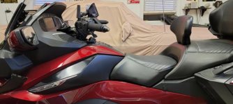

@ Jetfixer: Could you please post a side view of your spyder?
I replaced the original handlebar with one from the Spyder F3 because with full steering lock the stock handlbar touches my upper leg. The F3 handlebar solved this problem but now I am facing another issue: Since I am 6″4 tall, the handlebar is now too close to my upper body. Now I am wondering what would fit best: the long reach (219400910) oder the Attitude (219400911) handlebar?
Regards,
Alex
I'm thinking this view is what you want to see to tell how far back the bars are?
