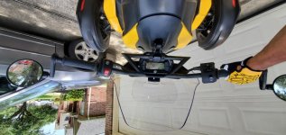

    I added the Z-Bars. They bring the grips up and back. (I don't know why the pic is upside down. Can't get it to rotate)

    Quote Originally Posted by jfuselier View Post
    I thought maybe you were in Australia...lol
