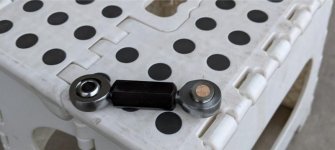

    I found it easiest to do a touch of super glue holding them in place while installing.

    YES PETER, there are 8 spacers in the small bag in the center of the sway bar photo.
    I just did a sway bar install and dropped the spacers a couple of times. I have another install in a week and will try the super glue trick.
