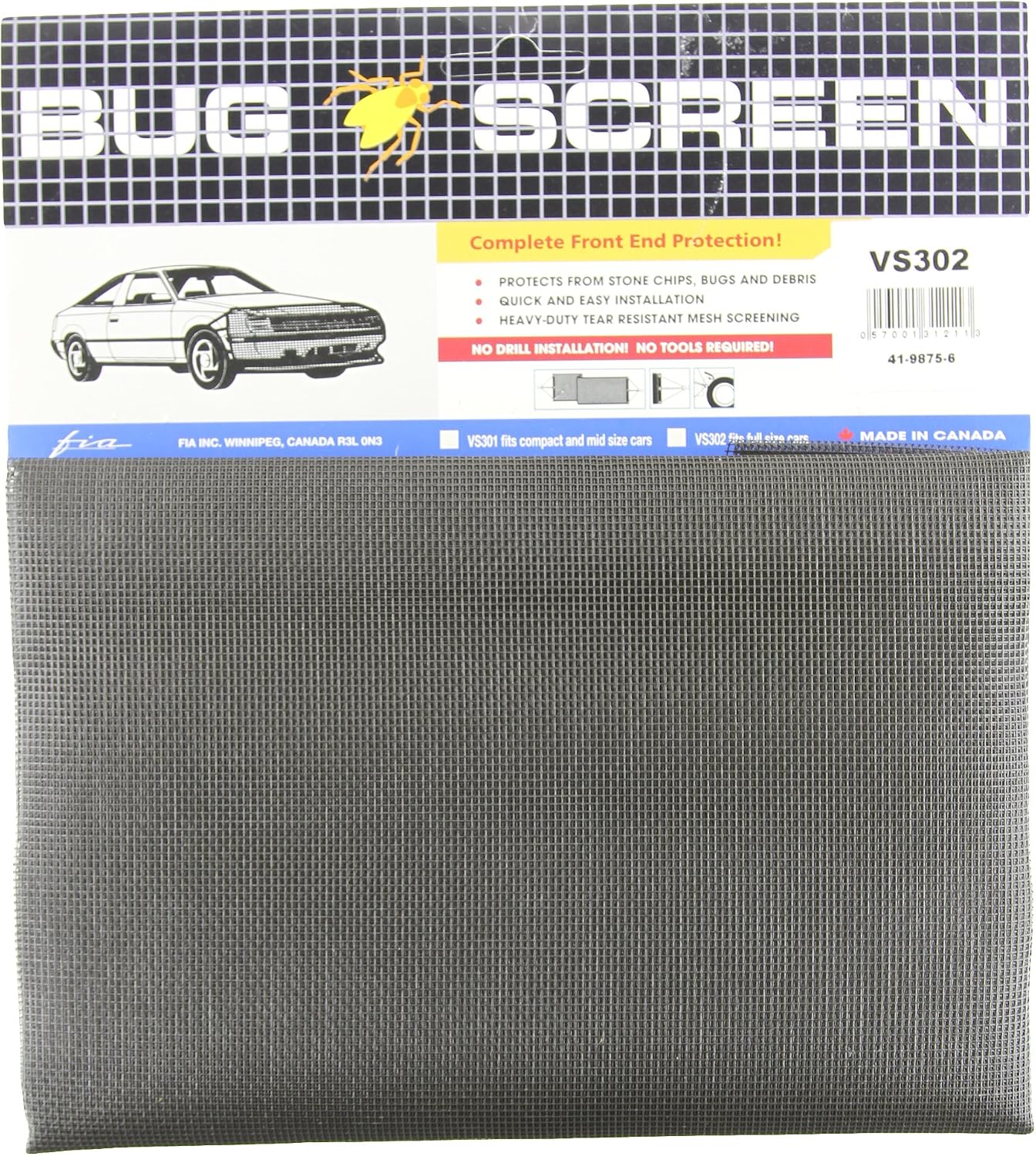

    There are bug nets which go over the radiator openings of trucks and cars down here for love bug season. They just fasten on with stretch straps. Wish there was something like that for the F3.
    Might could cut one from the universal screen and sew new border on it. They are soft nylon material and don't harm the paint.
