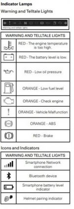

    Default 2018 F3-L. Manual does not explain this
    What are the symbols for battery and what looks to be a cell type of connection?

    Quote Originally Posted by acdcking12 View Post
    Does your F3-L have the updated 'Multi-function Dash Cluster' that I think the F3-T & L versions came with?? If it does, and you've got a 'battery symbol' that looks sorta like an 'AA' battery or the battery symbol on your cell phone, then I'd guess that those symbols are the 'Smartphone battery level' indicator & the 'Smartphone network connection' level indicator for your Smartphone/cell phone whenever it's connected to the dash!
    If the 'battery symbol' is more like a 12 volt car battery symbol, then I've got no idea what the cell type connection symbol might be, but the battery symbol is telling you either the F3's battery is low or dead; its charge system is dead; or there's some other electrical system fault....

    Default Warning and telltale lights
    From the owners manual. See below. If you can't download owners manual from BRPs website. PM me and I will put on my google drive for you to download.
