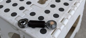

    Just finished installing mine today. Abrupt manuvers and taking curves at higher speeds definitely feels more stable. Here are my photos of the install. Getting those plastic blocks sure was a pain in the butt though!

    Quote Originally Posted by nycgordonf View Post
    about how long did the install take ? thanks, thinking of doing to my new f3 soon..
    any pics of the oem swaybar for comparison.. thanks
    FYI, the long bolt should be on the bottom.
    I am glad you like the bar. But I am afraid this is an unsafe install. As pointed out already, the long bolt goes on the bottom. I can see no threads out the end of the lower nut. The safety nylock feature is at the outer end of the nut. You need to have at least 2 full threads beyond the end of the nut to have an effective, and safe installation. I highly recommend swapping the bolts.
    Hmm, strange. The install guide clearly specified the included bolts should be used at the top. Wish I had a copy of the install guide but I tossed it.
    I torqued them all quite well.
    Not only that, the lower bolt is suppose to the other direction so the non thread part is in the sway bar. Less chance of movement in the sway bar end that way!
    Step 12. Using the LONGER 13mm Bolts supplied (Threads to the OUTSIDE), reattach the Lower Heim Joint Link to
    one Sway Bar Arm and Tighten (#3) Diagram #2. VERY IMPORTANT! The Sway Bar Arm mounts to the
    INSIDE of the Heim Joint Link. Repeat this process for the other side. If you have NOT installed the BajaRon
    Billet Aluminum Heim Joint Links, Check the UPPER Link Bolts for tightness. Some have found them loose.
    I am glad to hear that you torqued the bolts correctly. However, without threads into and beyond the Nylock portion of the nut. Even correctly torqued, this connection could back out. Neither of us wants that. The reason I supply the longer bolt in this bar kit is precisely because the original bolt is too short to make a secure connection with the new, thicker sway bar.
    Again, I highly recommend swapping these bolts. I am not saying it WILL come apart. But doing this will insure that everything stays put as designed. The manufacturer, and myself, use Nylock nuts for a reason. But they are not magic. For them to work as designed, they must have at least 2 threads beyond the Nylock portion of the nut.
    As for the bar kit instructions. I can send you another set if you like. In any case, these are the installation steps in question. I am posting this in the interests of safety only. Not to embarrass or call anyone out. When installed correctly, I firmly believe this bar kit improves the overall safety of the machine. It sounds like you went to great lengths to do this install correctly. It just needs a bit of tweaking.
    I have highlighted the pertinent portions in red here. They are not red on the instruction sheet. If there is anything else I can do, please let me know.
    6. Replacing the OEM Plastic End Links – See Picture on Page 4 - Upper Connection Point Only!
    Install the New BajaRon End Links Using the original Nut & Bolt. You will secure the top connection only at this time.
    13. Installing the BajaRon Heim Joint Links. - Sway Bar Connection Point Only!
    As with the upper End Link Connection, place one 8mm Stainless Steel spacer (supplied) on each side of each End Link bearing. Because this is an open connection, you will not find it necessary to use Super Glue for this step.
    You will be Using the LONGER 13mm Bolt & NyLock Nut (supplied). Attach the Lower Heim Joint Link to the Sway Bar Arm (Threads to the INSIDE) and Tighten
