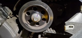

    Default Another one bytes the dust... Front Sprocket Failure - Red Dust!
    We're just going out of lockdown here (Portugal, Western Europe), doing a little Spring maintenance and just found this...
    Totally aware of the problem been doing routine checks at 5000km/3100mi intervals.
    For stats it's a 2018 F3-S euro model with 27000km/16777mi not using any belt tensioner, kept in a garage and driven 80% with no rain and mostly two-up.
    Now I could take it to the dealer and have them replaced the pulley or I could do it myself...
    For 2018 according to this: https://www.brppartspitstop.com/oemp...5e4/rear-drive
    I'll need:
    Sprocket 28 Thooth #705502134
    Screw-Hex.Flange Din.6921 S.Grip #250001017 (was #705502292?)
    Strangely according to this: https://www.brppartspitstop.com/oemp...-international
    Sprocket part number has changed since Sep.2020
    Sprocket 28 Teeth #705503239
    Is this an improved version? Which one should I get?

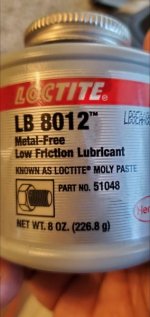

    Also there's seems to be two options when applying a paste:
    Molly Paste:
    Loctite 51048 Moly Paste Anti-Seize Compound /Loctite LB8012 Moly Paste Anti-Seize Compound
    While Lamonster seems to have a different approach and recommend Loctite 648 bonding/retaining compound.
    Any evidence or thoughts about this?

    705503239 is the sprocket. 250001017 is the flanged bolt.
    Doubt you will need the puller.
    I used Honda M77 molly paste. Not sure on Loc-Tite numbers

    Just ordered the new sprocket and bolt today so I guess I'll be doing it myself.
    153€+14€ = 167€ or around $200... not cheap.

    So in terms of what should be applied we have:
    Loctite LB8012 Moly Paste Anti-Seize Compound (or Loctite 51048/51049)
    Kluberpaste 46 MR 401
    Honda M77 (which replaced Honda M60) used for Honda shaft transmissions.
    Now LB8012 apparently meets the requirement of 60% molybdenum disulfide (which is the main stuff we're all after).
    A bit of controversy about Honda's M77 seems it does not meet the minimum needed 40% as the previous stuff (M60) would
    see: https://www.st-owners.com/forums/thr...tly-so.163897/
    Kluberpaste 46 MR 401 seems to not have any...
    But they do have another product listed as Molly paste: https://www.norelem.com/us/en/Produc...lubricant.html
    At this time, LB8012 seems the safest options...

    Kind of interesting to see you finding references to percentage of moly in the paste. Not sure where that info came from.
    From experience using various moly pastes, assembly lubes, and greases, I would be more focused on a moly product that retains some viscosity vs drying out or so thin it runs out. Often it seems higher densities of moly tend kind of gum up, while greases tend to dry up as the carrier base is worn away.
    Of the products you listed, my choice would be the Honda 77 which should be Molykote77.
    Regardless, Crisco cooking lard would likely outperform Kluberpaste.

    LB8012 explictly says +65% in it's datasheet: https://www.werkenmetmerken.nl/docs/...B_8012_TDS.pdf
    Now if Honda M77 is Molykote M77 then I think it may have other issues as the datasheet states:
    "Suitable for lubrication points with low to moderate loads and low speeds that are subjected to water and extreme temperatures; at
    temperatures above 230°C (446°F), the carrier volatilizes leaving virtually no residue, and the remaining dry sliding film itself takes over the lubrication up to +400°C (+662°F).
    Suitable for lubricating parts consisting of materials that are not resistant to mineral oils.
    Used successfully on metal/metal combinations with frictional and contact surfaces, brake anchor plates and the brake pistons of disc brakes."
    datasheet here: https://www.dupont.com/content/dam/d...1-0186G-01.pdf

    Not so much curious about the percentage of moly within the product vs where is the published data stating the amount required.
    Nov 2018
    Lisbon, Portugal
    157
    Oh that will never know as the paste BRP recommends seems to not have any.
    For me now it's more a question of getting the right stuff at the right price.
    Found LB 8012 and Honda M77 on ebay, both coming from the UK.
    454g/16Oz/1lbs of LB 8012 at 84,47€/$100
    or
    75g/2.6Oz of Honda M77 at 41,5€/$50
    I surely won't need 1 pound of paste and paying $100 for it seems a bit too much when I have already $200 in parts.
    The Honda stuff is much more expensive, but still half that what I would spend for the Loctite. Would a 2.6Oz tube be enough to lubricate the splines?

    Quote Originally Posted by MakoShark2 View Post
    Many times over.

    Many times over.
    Thanks. I just ordered the Honda stuff... 1 pound of loctite just didn't made sense.
    Now I'll have to wait everything to be delivered.
