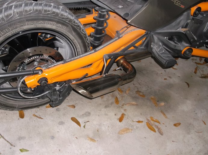

    Made the change yesterday for about $20 for 2 1/4 " muffler pipe elbow, muffler clamp and black engine paint. Sounds about the same but don't have to carry around that big ugly muffler.
    Now to figure out an easy way to take off the muffler hanger.

    Quote Originally Posted by Coastie View Post
    Made the change yesterday for about $14. 2 1/4 " muffler pipe elbow + 2 1/4 to 2 1/2" adapter + muffler clamp. Sounds about the same but don't have to carry around that big ugly muffler. Painting it flat black tomorrow. The engine paint was $19 - more than the "muffler."
    I like the idea, but we need a picture and a sound clip

    Quote Originally Posted by mully View Post
    I'll put a picture on my list of things to do. Not so sure I can do a sound clip.
    First got to take off new tail pipe to paint it. Have to put stock exhaust back on to take Spyder to local dealer maybe Tuesday. The cover over the coolant seems to be too small. The front tab won't stay caught at about 50 or above. Lifts up front of cover and wind vibration might break it. If was going to dealer where I bought it (80 miles away), I wouldn't bother to put muffler back on but due to local dealer's reputation, I think I better.
    Locally, a few years ago, there was a 1330 powered RT that had a similar setup as you describe. Essentially running the converter and no muffler, but had a very short downturn stub pipe.
    I was able to ride with them both in town and on the highway. It was pretty loud. Certainly seemed a bunch louder than our Spyder which is also an RT with a 1330, but runs a bypass pipe and stock muffler.
    A few months later I saw the Spyder again, they had gone with I believe it was a stock muffler and bypass pipe. Reason was with the exhaust outlet so far forward, and being as loud as it was, it was just too much.
    I have retained our converter, sits on a shelf. About three years ago I also made exactly what you described. I never took the time to reinstall the converter and with it the stub pipe. Maybe someday, or maybe not.
    Our greatest benefit was heat reduction, and that is something I prefer not to bring back.
