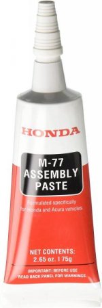

    Shop manual calls for KLUEBER Paste......research for answer.......$$
    I use the Honda stuff....
    L

    Just a heads up ....... I'm pretty sure " Anti-Seize " paste is NOT what you should use .... there are special " moly " pastes made for type if application. ..... I would check some of the other posts or PM ... PMK ...... jmho .... Mike
    Aug 2019
    Stoughton, WI
    2,565
    Your Honda dealer should have this...
