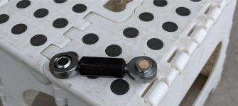

    Well I got my Baja Ron end links for my Ryker. Now I'm waiting for half way nice weather to install them. Orderd off of FB and got here pretty quick.

    Just a word of advice when installing them. They have spacer washers that go on each side of the end link. Add a little dab of grease to the washers so that they stick to the side of the end link when slipping the bolt through.

    I ordered them off of FB too, couldn't find a website at the time. I think that you're gonna like the improvement.

    Put a wooden dowel in the link end and spacers and push it out with the bolt. Do not over tighten the bolts or you will damage the spacers.

    It really isn’t difficult to put the spacers in. I did it first try without any tools.
    It is well worth this upgrade. As you aren’t replacing the anti-say bar this won’t take long at all.

    I was thinking the same thing. I don't have any grease but I think Vaseline would work too.

    After watching a couple of DIY videos on YouTube, I decided if I were to replace the sway bar I'd take it to the shop and let them deal with it. My patience and back would not last long enough.

    Vaseline will work fine.
