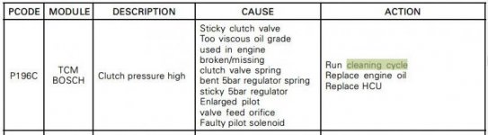

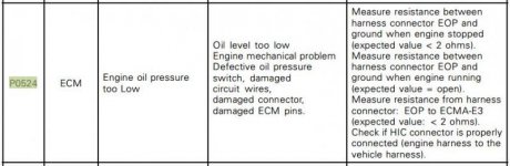

    Tried going for a ride this morning. I could tell something was not quite right as it took a little more throttle to get going and the take-off was jerkier than usual. I attributed this to the colder than usual temperature (mid 40's). Once moving it ran fine. About 5 miles from home, the engine quit at a stop light. This has never happened before. When I restarted, the trike was in limp mode. On the way home I had to ease on the throttle very slowly or the engine would quit. The idle was around 1500-1600 instead of 900 and engagement was very jerky. At home I read error codes P196C (Clutch pressure high) and P0524 (oil pressure low). Oil level is fine. As per other suggestions, I removed the key for a couple of hours and tried again - same thing.
    For the P196C code, the shop manual says to run the cleaning cycle. What is that? I could not find a reference. It also says to change the oil.

    The cleaning cycle is the process of (using BUDS) clearing the memory tables of computers,learned values from driving.

    Update - Dealer finally got a look and diagnosed "no oil pressure". No cause diagnosed at this time. Now they are waiting for Can-Am to give a go-ahead for warranty work.

    As I previously posted, I received these error codes after riding a short bit about a month ago. The trike went into limp mode and I managed to get it home. The dealer picked it up a week later and their diagnosis showed no oil pressure.
    After finally getting approval from BRP they started taking things apart. They told me that they found two thrashed gears in the oil pump and sent photos to BRP (I did not see the photos). No indication as to why these gears failed. Could be defective parts or incorrect installation, I suppose. I just hope it is not an inherent problem with this engine.
    Due to the likelihood of further yet undiscovered damage due to no oil, BRP is sending a complete new engine. It will take at least 2 weeks to get here and probably another week to install. It is really disappointing having my ride fail after just over a year. Riding is one of the few things I can still enjoy, and each ride is precious when you have a lot more riding days behind you than in front. However, kudos to BRP and my dealer for taking care of this problem even though the time it is taking seems excessive.
