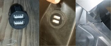

    I like to keep it simple and low cost when possible. I bought a dual USB outlet that fits the power plug in the trunk. It fits almost flush as in the middle picture. I then cut a small notch in the plastic at the top of the trunk to run either one or two USB cables through. I currently have just one 10' installed with it run tucked in along the padding of the trunk down and under the seat then back up and wrapped around the handlebars so I can use it to plug in either a phone, GPS or camera battery charger.
