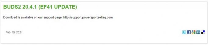

    There appears to be an update to BUDS 2 released Feb 10, 2021. The update may be for a snowmobile, who knows. What I do is just before I plan to use BUDS2. I check for an update and install it if there is one.
