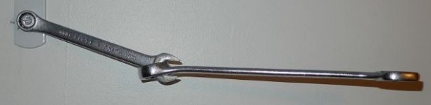

    To start you need two 36mm wrenches and/or sockets. I ordered this 18" long big boy 36mm end wrench and have a 36mm socket for the oil filter. I have used my long handle torque wrench for jobs that need more leverage or I have a pipe that fits over my breaker bar.

    If you don't have a torque wrench that goes over 160 lb-ft get a 36 mm extension wrench. They're available as VW or HD wrenches. With the extension you can easily get 160 lb-ft torque on the axle nut by taking the wrench to something like 110 to 120 lb-ft torque. Do a search here, or on Google, for torque multiplier wrench.

    Thanks to all. I ordered a 36mm box wrench and give it a try.

    You'll need two wrenches, as the bolt will spin if you only turn one end. But I assume you already have the socket.

    Thanks for the info. My brain must have went blank for a while. I returned the 36mm socket NOT THINKING that the axle will turn. I'll just go buy it again. I love getting older as it gives me an excuse to act dumber. (I talking about me-nobody else)
